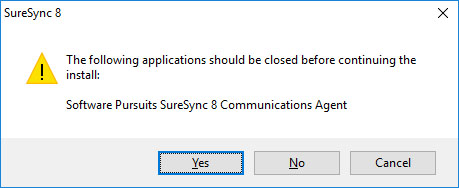

Prior to upgrading to InstallAware X6, my installer would automatically and silently stop and remove two services on uninstall. Now I receive a prompt:
"The following applications should be closed before continuing the install" that the user has to answer. Is there a way to turn this prompt off? The services need to be stopped and removed so the prompt introduces the possibility of someone saying no and a reboot potentially being needed for no reason.

Re: The following applications should be closed prompt
Posted: Wed Mar 01, 2017 3:44 pm
by jkrasky
Hello FrancescoT,
Attached is a screenshot. We have been building setups in InstallAware since probably version 10 and we've never seen this prompt with the same setup file. It appeared only after building on InstallAware X6 so I assumed it had to be a change in the new version.

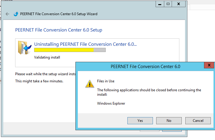

Well, I spoke too soon. The above fix worked for one of my installs that has services but now a similar error is occurring with another program, one where we install a DLL that is a shell context menu for Windows Explorer. After removing the shell context menu, we see a dialog box prompting us to close Windows Explorer - THIS IS VERY BAD as clicking Yes takes down the whole O/S shell.
FileInUseFCC-Windows 10.png (30.23 KiB) Viewed 34144 times
In our uninstall code, before we call ApplyUninstall I am unregistering the shell context menu dll, and the call does succeed. I can see this when I show the window and run the regsvr32.exe in non-silent mode as in this mode I have to dismiss the dialog before proceeding.
I added the NATIVE_ENGINE settings around these calls but it didn't make a difference.
    Comment: Unregister context menu shell extension
    Run Program $WINSYSDIR$\regsvr32.exe /u "$INSTALLED_LOCATION$\PNFCCSCM6.dll" (WAIT)
    Run Program $WINSYSDIR$\regsvr32.exe /u "$INSTALLED_LOCATION$\PNFCCSCM664.dll" (WAIT)
    Set Variable NATIVE_ENGINE to FALSE
    Comment: Unregister bins and profiles
    Run Program $INSTALLED_LOCATION$\PNFCC6.exe /unregisterbins (WAIT)
    Run Program $INSTALLED_LOCATION$\PNFCC6.exe /unregister (WAIT)
    Comment: Remove printer
    Run Program $INSTALLED_LOCATION$\Setups\PNSetup.exe /REMOVE (WAIT)
    Install/Remove MSI Package $PRODUCTCODE$[REMOVE=ALL] (get result into variable REMOVEOLD)
    Comment: Remove swid tag files so directory is deleted.
    Delete Files $INSTALLED_LOCATION$\*.swidtag (when uninstalling)
I am building on X6 (23.01), currently migrating to X6 (23.03) to see if that helps.
My QA team tells me they see this behaviour on he following WIndows platforms:
- Windows 8.1 (x32 & x64), Windows 2012 R2, Windows 10 (x32 & x64) and Windows 2016
- No prompt box on Windows XP – Windows 2012
Any ideas?
